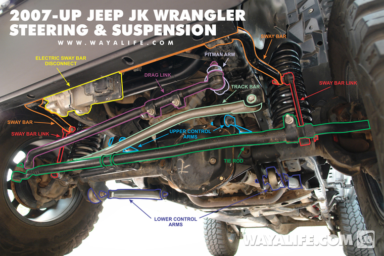

Honestly, installing a lift kit isn't too bad. Just take your time and read through your directions step by step. However, be prepared to spend more with that much life. You'll most likely run into driveshaft issues in the future. I attached a diagram that should be helpful for the front end. Sorry I'm at the other end of the country or I'd help you out. Oh and make sure you have a good torque wrench. Click image for larger version
