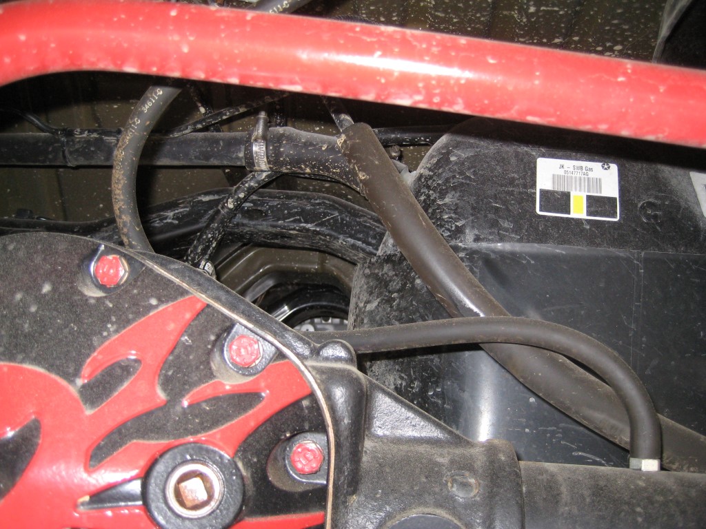

Y rear breather hose is hitting my heat shield. O had a shop install my lift so i do not know how it should be routed. I have a 3" lift. Does it need a longer hose to be routed the right way? It is on a 16' hard rock rubi. Pics would help!! Right now it comes off the axle towards the back under the crossmember then back towards the from the mount on the inside of fender rivet. Thanks in advance for your help!!

I have a 2.5" lift which netted 3.25" in the rear. I extended my line and ran it this way.

14Sport has it set up well, I took it a step further and went into the taillight cavity. If I'm that deep in water then I've got bigger problems. His routing also avoids the heat shield.

Great pictures. Thank you!!
