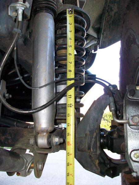

Okay, it looks like the rear springs have about 12.5" from the axle to the flat underside of the spring perch on the frame. On the front, it looks like 13.25" from the spring perch on the frame to
the bottom of the spring on the axle.
This is generally considered a 5" lift, though it's probably settled due to added weight, time, and whatnot.

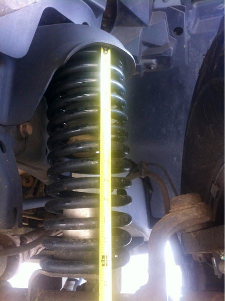

Show around 13"..

Any idea what this means as far as the height of the lift... ?
