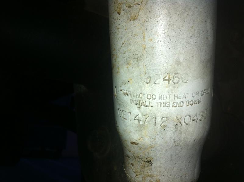

This is the number on the shock... googles it and nothing comes up... really wierd...
<img src="https://www.jk-forum.com/forums/attachment.php?attachmentid=280444"/>

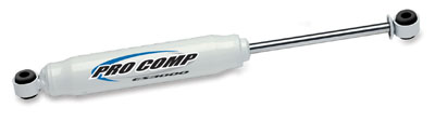

The shocks are Pro Comp ES92450.
The Pro Comp ES9000 is the ultimate nitrogen gas charged shock absorber. With its twin tube design and 10 stage velocity sensitive valving, the ES9000 delivers not only a smooth, comfortable highway ride, but it also enhances off road handling and performance. Engineered for those driving enthusiasts demanding optimum capacity for heavy loads as well as the most demanding driving conditions. It's a 1 3/8" nylon banded full displacement piston head and double welded shock mounts ensure maximum strength and long lasting durability. Choose the Pro-Comp part number you need from the table below:
ES9000 SHOCK SPECIFICATIONS
(Dimensions given in inches)
PART # EXTENDED COLLAPSED TRAVEL TOP MT BOTTOM MT BODY DIA.
92450X 24.84 14.82 10.02 Loop Loop 2.36
Attachment 280444
Pro comp I am guessing.
