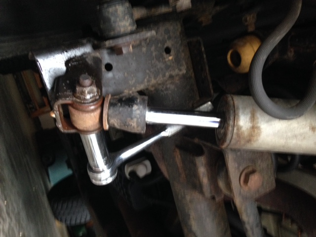

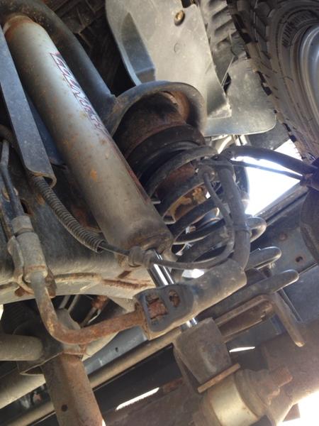

Of course, I am a new jeep owner and new to "DO IT YOURSELF". Can anyone tell me what type of shocks these are and perhaps recommend a decent operating and looking replacement?

They look to be a monotube of some make.
Many people like our adjustable RS9000XL shock, you can have a soft or firm ride when you turn the knob.

theyre rough country. Replace them with the Rancho 9000xl's. youll be pleased with them.

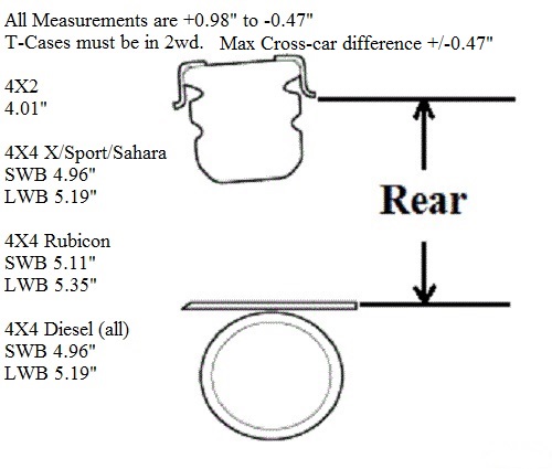

Best way to measure lift is using the factory measuring points and seeing how much you differ. See pics.

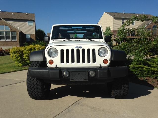

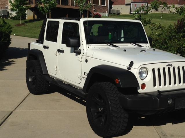

Here is a pic of the front: Click image for larger version
ID:	611472Click image for larger version
Here is a pic to the front view: Click image for larger version
Here is another angle: Click image for larger version
