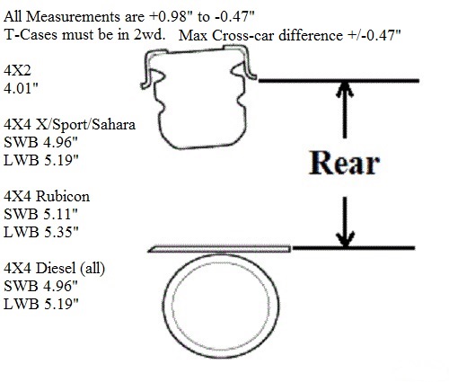

Best way to measure lift is using the factory measuring points and seeing how much you differ. See pics.
Attachment 611445
Attachment 611446

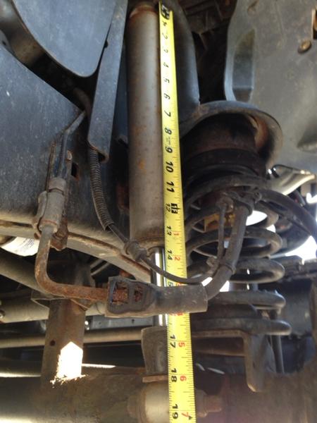

Assuming I measured correctly, it looks to be stock?

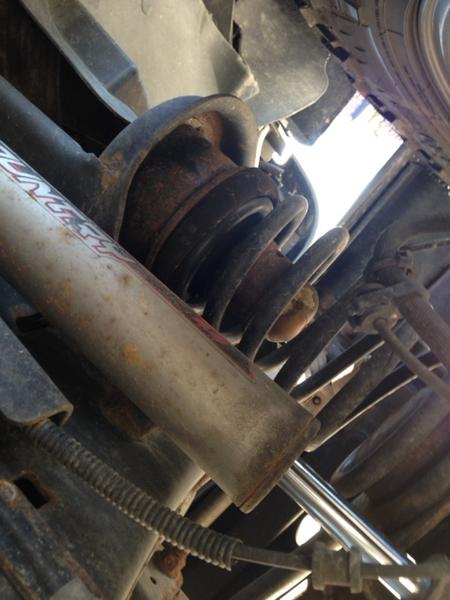

Originally Posted by jaxhammer
Lol, the shock says rough country. Guess that tells you what type of shocks they are...
Is that a spacer on top of the coil? Look on their website at the 1.75" and 2.5" spacer lifts. If it's the 2.5", it should be pretty easy to compare the components to what you have.

Yep looks like a spacer there.

Looks like the factory isolator to me. And based on the measurement, hard to believe the coil sag is that bad.
After comparing what is there to photos of an isolator and/or spacer, it looks more like an isolator. Given that it is the isolator, should I be concerned about the coil sag?

Looks like a spacer above the factory isolator to me.
