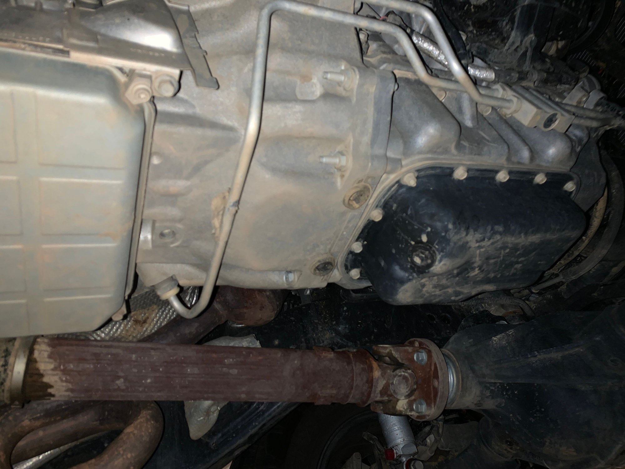

I have a 2017 Sahara JKU, I looked under it and all that is on it is factory armor on gas tank and evap. Does this change priorities?

You should have a transmission skid or your motor would fall out once the motor mounts broke.

It is the 3.6 auto. Is this a common issue or is it just me?
I bought it used at a dealership and it was bone stock with low miles.

I thought that was standard, maybe they did away with the skid on later models. So you just have the transmission cross member and nothing that goes from side to side under the transfer case? I was just joking about the motor falling out.

3,6L auto JKU came with tc skid, gas tank hanger/skid, and a wimpy ass little bar protecting the tranny.
