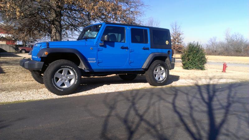

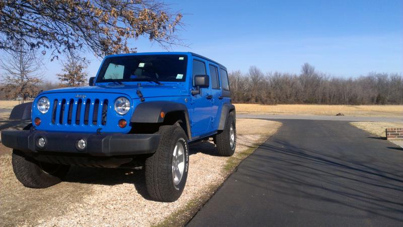

Old Jan 22, 2013 | 08:06 AM
wshearrer's Avatar
Posts: 35
From: wagoner,ok
Trying to get you a pic
