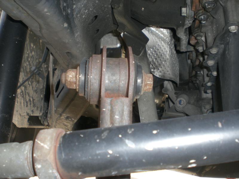

Adjustable uppers and lowers.

What parts did you install? It looks like you have a 2-door. If you just installed 3" springs in a 2-door with nothing else, I'm not really surprised to hear that the steering feels loose. You probably netted quite a bit more than three inches.
I just helped another member install a 4" lift on his JKU. We did install LCA's and a drag link flip kit, along with some brackets to deal with the trackbars. His Jeep drives every bit as good, if not better, than it did stock.
