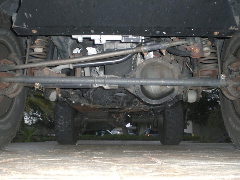

Front end of jeep

Track bar at the axle.
Teraflex, did you figure out which kit I had?

Originally Posted by jeepingalong
Front end of jeep
JKS trackbar. Can you post a pic showing the rear suspension?

Looks like you got one of the earlier model jks trackbars that had some flex in them, so much so they'd snap. Also, it may just be the angle of the pic, but your driverside coil looks like it has a serious forward bow in relation to the bumpstop, is this true?
some jks tb probs
https://www.jk-forum.com/forums/show...t=jks+trackbar
