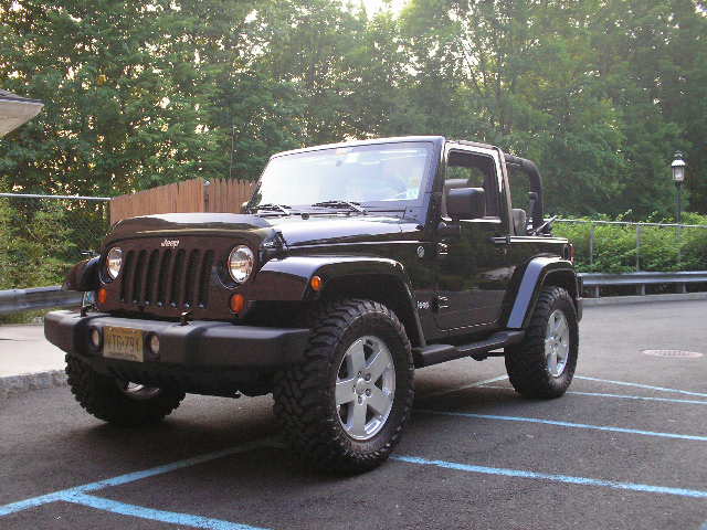

After much searching... what I want to do is exactly as seen below.... arincmax's setup...Toyo open country 33x12.50 R18 with no lift. (my mind has gone a little numb and I thought this setup included 1.5" spacers, but now I'm not sure).....

- Can anyone confirm if this setup, as pictures is using spacers?

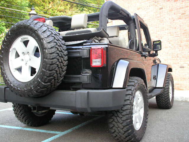

- I think my research tells me I should have no problem mounting the spare on the rear gate.. Yes? No?

If you are going to run stock wheels and those tires, then you will need spacers.
I don't know what gears you have but you will notice a difference in power but mostly just the overdrive and maybe on hills. It won't be too bad though.
Even with wheel spacers you might get a little rubbing at full turn. It might still hit the junkie plastic piece that wraps underneith from the front bumper. It won't cut down on your radius unless it hits the sway bar links.

No problem mounting the spare.
