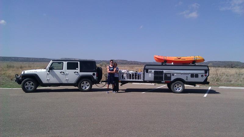

I tow a 2700lb pop up with my JKU and it does pretty darn good. I would not pull something that heavy without trailer brakes though. Trailer brakes make a HUGE difference. I actually get better gas mileage pulling the trailer than not pulling the trailer. I also don't try to go faster than 65 pulling a trailer.
However, I just picked up a Jeep Commander with a Hemi so the JK isn't on trailer duty anymore.

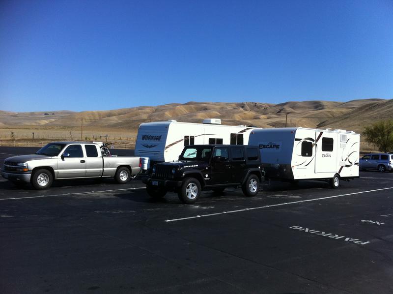

I've been pulling a 19' travel trailer that has a dry weight of 3,000 lbs. for the past year. I have 4.10 gearing in my Rubicon and had the stock 32's on for the first 6 months of towing. Then I lifted it 2.5" and went with 33's so I can offer my experience with both set-ups. I live in the Central Valley of California so just about anywhere I go I have to climb and descend a mountain range. I've made several trips to the coast (with both set-ups) and tackled the 6% grade there. It was easy with the 32's and had no problem maintaining 55 mph. With the 33's I'm barely hanging on to 45 mph. This is, by the way, usually with 4 people and 1 dog in the Jeep.
I've also pulled to Big Bear Lake and Lake Tahoe. Both tough pulls. Both were with my 33's on and it was slow going. But I was going as fast as the trucks pulling trailers so based on that I think I did fine. Going to Big Bear I chose the easiest way in with the most gradual climb. Coming back I took the steepest (and quickest) route home. It was posted as an 11% grade! I just kept it in the low gears and took my time coming down. Didn't use the brakes all that much when I used the gears properly. I never heated up the brakes and stopping power was there when needed.
The absolute toughest climb I've managed so far is the climb up out of Lake Tahoe where I'm climbing a very steep (not sure what % grade, sorry) road for several miles. I had to drop down to 1st gear and maintain RPMs around 5k just to keep it moving. I was doing everything I could to keep my speed at 30 MPH. The engine did heat up to about 3/4 on the gauge, first time that's happened. I was not the slowest RV on the road though. We actually caught up to a couple trucks pulling 5th wheels going even slower. In hindsight, I guess I would have been fine at a slower speed myself and not pushing my rig like that.
So, done right, it's my opinion that the JKU can handle every bit of the 3,500 lbs. it's rated at. However, I added the following mods specifically for towing:
- B&M Trans Cooler
- Superchips Tuner
- Airlift Air Springs (bags)
- Brake Controller
- Weight Distribution Hitch with Sway Control
I've never felt unsafe while pulling. Stopping power has been fine, not great, but I've managed to stop every time so far. Just allow a little extra time. I am upgrading to Hawk LTS brake pads in the next couple of weeks that will probably help out a little more. If you will be towing more than rock crawling, they have another pad that is better when hot than these, but I suspect the LTS will be at least as good as the stock pads while towing, but definitely better when cold. The sway has been fine. I've never felt like the trailer was pushing me around. Gearing was good with 32's and 4.10, but with 33's, I'd prefer something around 4.56. With 35's I'd be looking for 5.12.
Here's the trailer I'm pulling:
Spree Escape 196S by KZ
