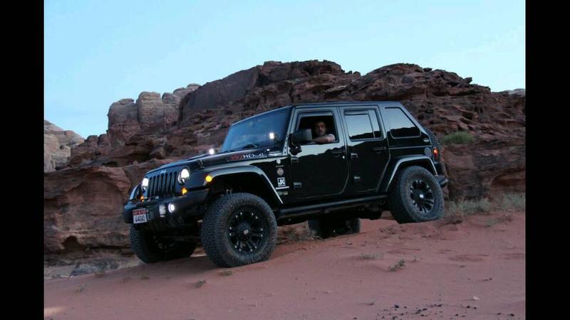

This is my Jk it's got the AEV hood, I liked the hood from total innovations but didn't like the high hump on it.
Attachment 466977
Saeed Alfahim
Yes, some like it some don't...
I pointed to them that many people don't like the hump, and asked if they would consider making it wider and lower. They wouldn't even consider it.
Good looking Jeep! I like the slanted top.
