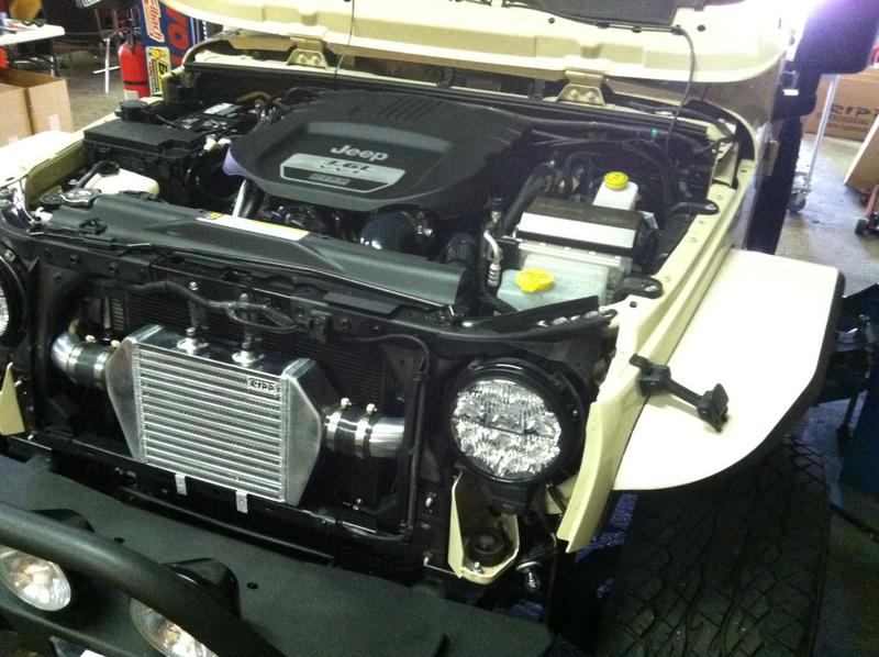

We are coming out with a system for the 3.6. It will be bolt on with an integrated intercooler. The initial design is done and engineering is working on a prototype that should be running by February. We should have production systems on the shelf by June. The system is designed for lots of low end torque.
With the exception of the ability to upload our tune, our System has been ready to go for the past 13 months, we are just waiting on the Diablosport unit to be more stable in it's uploading to the locked PCM, We expect release in 45 days.
We have designed our system to produce significant power gains throughout the entire RPM band, not in just one spot. Expect to see gains whether crawling through Pritchett Canyon trail in Moab, or Doing 75 MPH (
) with traffic on 37's on I80, without having to downshift.
RIPP
) with traffic on 37's on I80, without having to downshift.RIPP
Attachment 405235
Attachment 405236
RIPP
Attachment 405235
Attachment 405236
