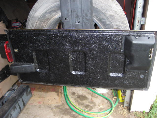

I might be a little late on this thread but thats life. I lined the rear tub and tailgate in my 99 TJ and it worked great. The herculiner will stay on your skin for a while. I'd recommend latex or rubber gloves. The roller that comes with the kit SUCKS A FAT ONE. I'd recommend using a sponge brush or regular cheap paint brush, rolling it just didn't work for me. The finish is rough but thats kinda the idea. If your looking for an even tone/texture this isn't the product you want. Be sure to sand the clear coat off to allow the liner to adhere correctly.
