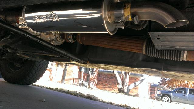

Originally Posted by Cutman
SWEET!!! I ride around with a 5 year old in the back. I'm not sure about dumping poisonous gas underneath his seat. This looks like it will work for everybody.
You never smell the exhaust.....it does not drone........
Awesome! Thanks for the pic! And thanks for your service.
Last question for real. If i install the 39524 on my 2 door, will it dump the exhaust before or after the axle?
It will dump before the rear axle.

Originally Posted by Yamaha90
if you guys are adding in their "rock crawler" muffler, you can either make the exhaust dump before the axle by just adding a turn down, or you can always add their tailpipe piece (55428) to have the exhaust exit through the rear.
What i did was chop off the stock muffler, add in the Dynomax muffler with some cutting of the factory tubing. Clamp in the new muffler and you're good to go. I will be adding the tail pipe section after xmas because there is a long box in the basement that has threats written on it if I open the box..
Yep!! The DIY route is VERY popular. The muffler used is P/N 17263 with some 2.5" clamps.
Before axle....behind driver
Yep.
