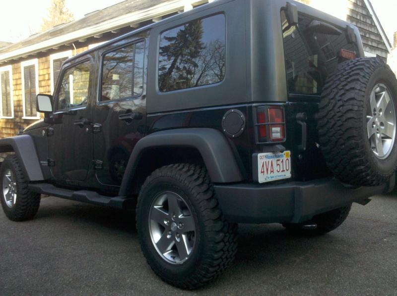

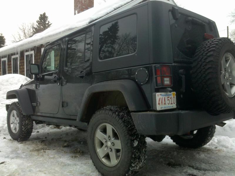

I just installed a Rough Country 1.75 in lift with my stock Rubi tires. I think it looks great and would give you plenty of room for your 33s. Install was easy, didn't change my stock ride whatsoever. Pic in the snow is lifted, other is before.
