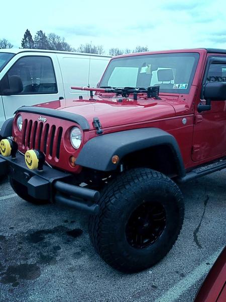

the hood i love mine on there Click image for larger version

Mine started under the back seat, and then I put it on the rear roll var with a RROR mount. Then I tried it on the hood. Just didn't like it out in the elements and it partially blocked the washer spray. Kind of sucks when your in the dirt and dust and can't get your windshield clean. The elements really do havoc to the jack too. 6 months on the hood did more wear on the jack than 3 years of use and being mounted inside. Now it's back on the river raider mount.

I Would go under the back seat but my amps are under there so there probably wouldn't be any room, I think I'll go with the hood mount

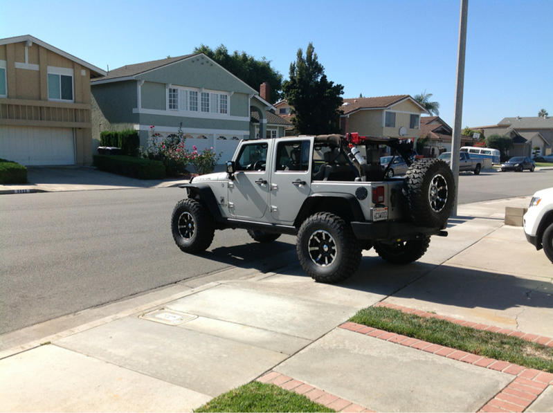

Upper part of the rear roll bar. Jeeps swag has the mounts and you can remove it easily even with the hard top on. No vibration and completely out of the way. Plus there is no concern about the hi-lift out in the elements. This pic kinda shows how it's mounted.
