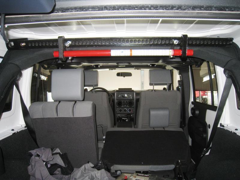

Rugged ridge rear mounts out of the way, and easy to get to...works with top on and off...works for me !!
I really like this one, how much was it and do you think it would work with my two door???? By the way I have the same tires and I love them, what size are they? I have 265/75r16 but there almost done so I'm going with the 305/70r16, can't wait

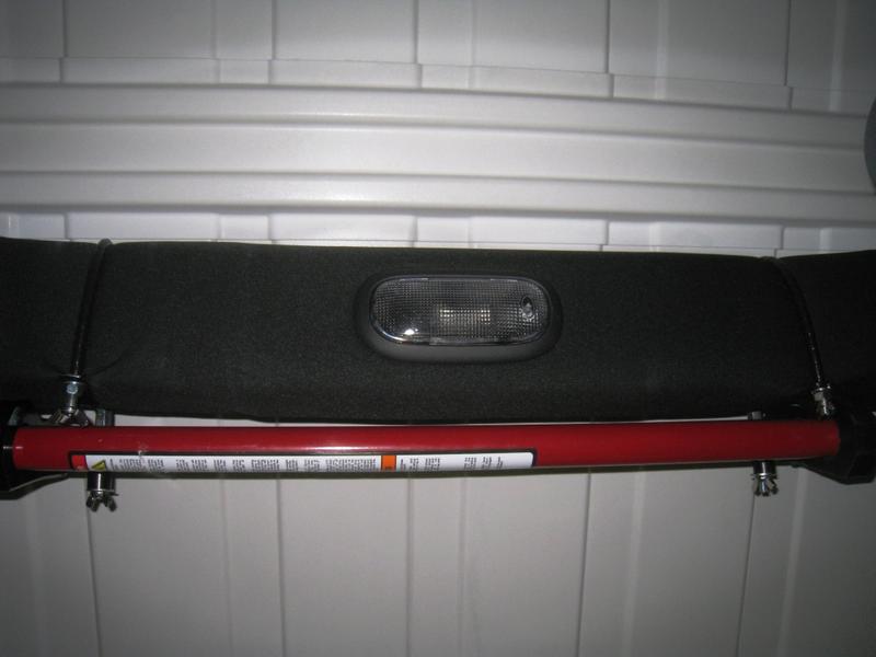

I used threaded rod, wrapped it in black electrical tape and bent it around the roll bar. Got some wing nuts, the hi-lift isolator and mounted it up high behind the back seat. It cost $12 total I think. It is tightly secured, out of sight from thieves, and not going to jab anyone in the head. Cheapest hi-lift mount I have seen!
No dents on hood, wiper spray works, it's clean all the time and not going to come loose unless you unscrew the wing nuts.
**Edit** I have since turned it around, attached the main working part and have it up high off the floor. (I originally had the main working part in the little cubby hole, but wanted to put other 'stuff' there)

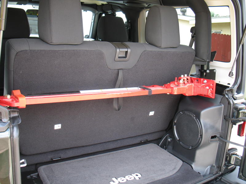

I have the one from Quadratec but had to return the first one because it didn't fit properly on the 2 door...I now have one that specifically made for the 2 door and it fits perfectly.
