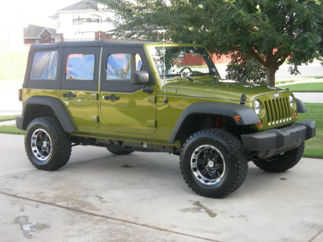

I have an auto. Here's a picture.

Ur jeep looks good with those half doors......

Damn, I love the wheel and Color choice!

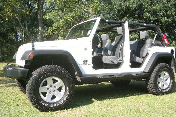

I have 35in Cooper STT's about the same as the Toyo's. Also have 4.10's, like Deep sky said , press the OD button off and you'll be good.
