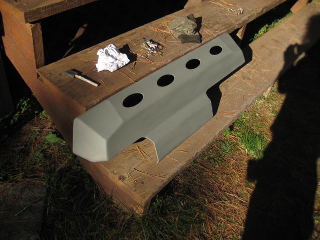

Old Feb 17, 2014 | 07:18 PM
jeepmojo's Avatar
Posts: 2,318
Likes: 12
From: New Hampshire

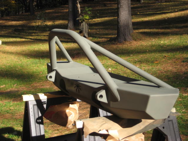

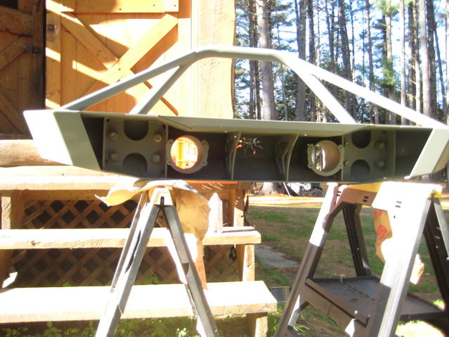

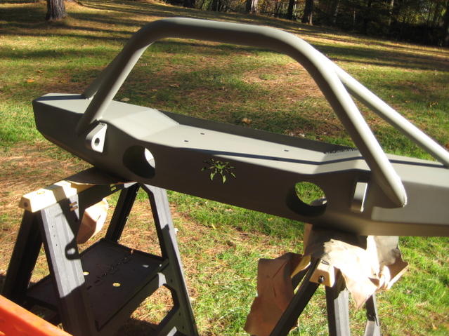

Default ive only got the etching primer done waiting for weather to change in april lol
right now snow banks 7 feet high it will be some time. 3 coats of etching primer , but first clean it down with alcohol. not rubbing alcohol then spray it w/primer
then 2 or 3 coats of bed liner / rustolium bed liner spray

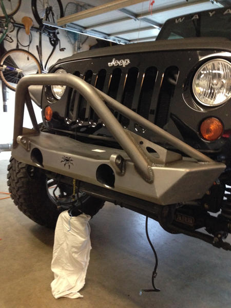

I powder coated mine, clean looking and can always touch up with a rattle can if need be. Ordered my PSC custom !!

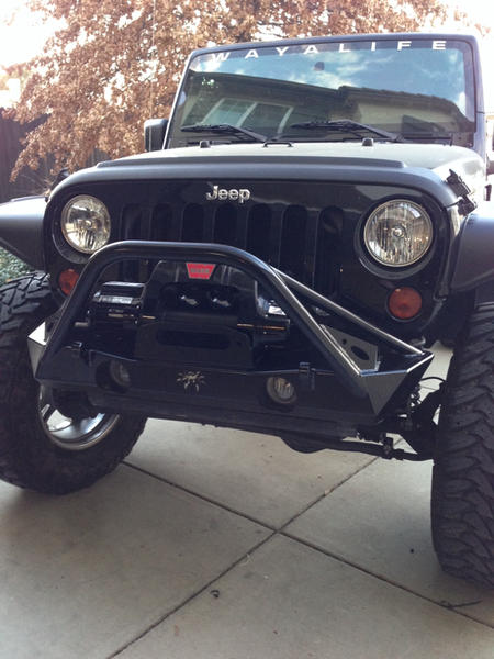

i dont think they needed them other than the looks but sets it apart from others in away
toss a few more photos in better lighting and angles after it was installed ! the tube gussets are way better looking than with out and having both is that much better. didnt even know that was a option having both
