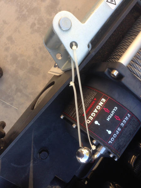

Winch from bouncing out of engaged into free spool when not in use. When it does this the line goes slack. Happens all the time when I'm off road or even around town. Then I have the pita job of unspooling the line and respooling it in snug. Does anyone else have this issue and what have you done to remedy it. I have the smittybilt xrc 8 sent from the slow lane

It stays engaged while in use and has never popped out on me. Although I have only really used it 3 times. I have it under tension with the hook attached to a D ring. But when I'm off road or on a bumpy street it sometimes pops into free spool anyways.
Here is my temporary solution. Not pulled down tight enough to cause pressure but just enough so it won't pop over the ball and keep the lever in the engaged position.

Looks like you've got the best solution possible without pulling it apart and finding the issue.
Is it under warranty?
Will smittybilt send you replacement parts if you do it yourself?
Can it be sent somewhere for repair that will only charge you if they fix it?
