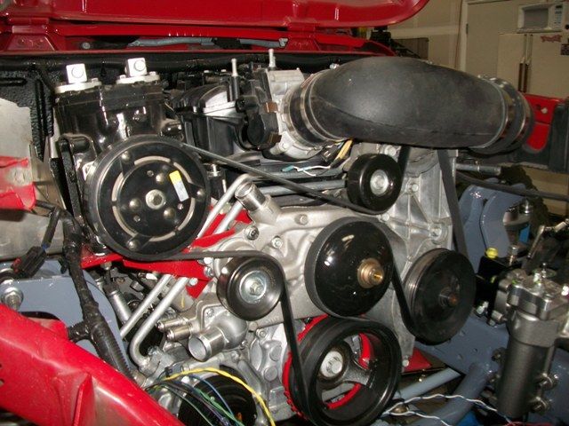

We have many Hemi swaps in Reno, that are legal their. I do not know about LS swaps in the Reno area, but my understanding is the same year or newer law, also it has to be a light duty engine.
Now in California, the law is same year or newer, light duty engines and the trans is part of the smog Equipment. Also the federal law is that the Jeep has to be out of emissions warranty and that is 8 years or 80,000 miles, so we can get a new emissions label.
We have passed many LS Jeeps in Cal.
We are tiring to make our LS kit easier and faster to install, with a high quality in our parts!
