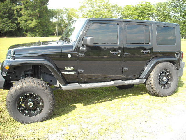

What is the best and cheapest way to gain a little horse power. also my jeep jumps out of overdrive a lot on the highway. Do I need a new gear I have a 08 4 door sahara on 315in kumho mud terrains with 17on xd hoss rims.
