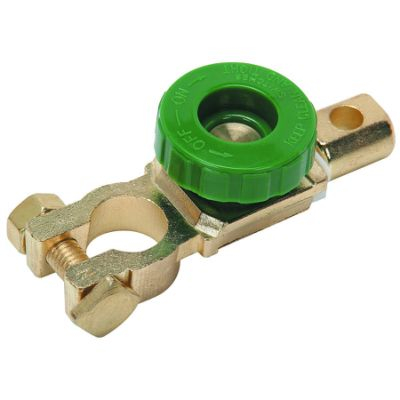

one thing that helps if you have the ability to lock your hood, a battery disconnect. I use the 'turn knob' style that hooks up directly to the battery Click image for larger version
ID:	598292edit: good addition for those of us without an alarm

My thoughts exactly. If they're gonna steal it, they're gonna use a flat-bed to haul it. I'd rather keep the battery connected so at least the vehicle alarm will trigger and the Mopar hood lock I have will buy me enough time so I can hear it go off....

Unfortunately, in the last 2 months I've had two friends loose their jeeps because a duplicate was made from a dealer. The chip is great if their not using a copy. All they do is take a pic of your Vin and bam, one phone call and a key is made for your ride. I rather add a kill switch and not a battery disruption under the hood. I rather be able to flip a switch instead of un latching my hood in snow to start my car.
