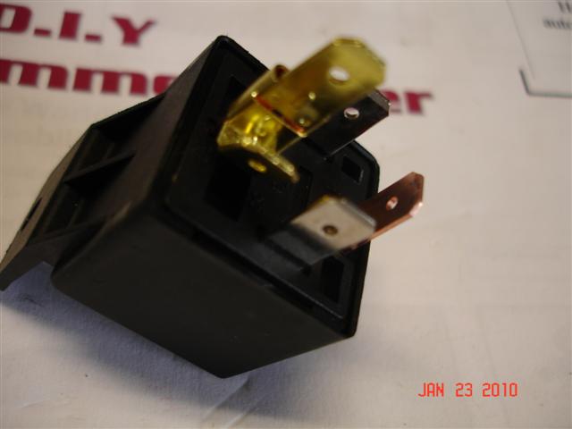

I'm torn if I should kill the fuel pump or just stick to the starter on a Automatic.
If everything fails and it's just the starter it won't start, but If it's the fuel pump it could die while moving which could be a bad day. I was thinking about using a latch relay set up for the fuel pump to prevent failure if the signal is lost, but I'm a wiring amateur and not sure if this is the best route for reliable fuel pump power.
I wouldn't worry about it if you build in your override. Whatever oem circuit you cut into and attach to pin 30 and 87, can easily be overrode by using a dual tab on the 87 pin at the back of the relay. When I needed service, I would just unplug the wire on pin 30 and plug it into the second tab on pin 87 along with the wire that was already on pin 87, completing the connection back to stock. Here's a pic of the dual tab I used.
Great info, my concern was loss of fuel on the interstate or in a spot where you need to keep moving or else you risk life. Worse case scenario stuff where you wouldn't have time to manually rewire the relay.
