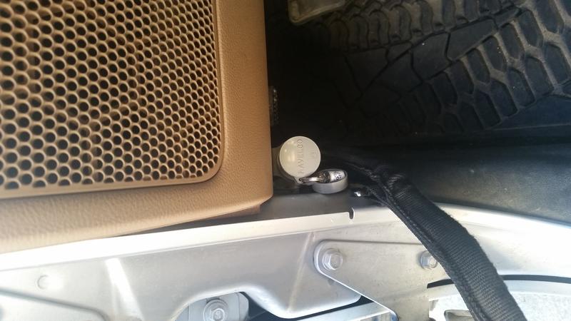

located in the driver kick panel out of the way
installer will put it wherever you want.
Attachment 598741
Thanks man.

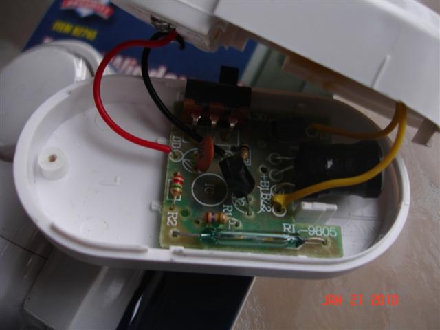

If you do anything trick, my advise is to build in an override like I did with mine in case you need to bring the Jeep in for service. The last thing you want is to have to show someone how to re-enable your rig.
And dog, if you want to use a reed switch, this is how I did it in my T/A.
I pulled the reed switch from a 79 cents HF alarm.
Because the leads were so tiny, I just cut the circuit board and used it as an assembly.
ID:	598887   Click image for larger version
ID:	598888   Click image for larger version
Good idea about the hidden override. I tested everything out last night and it works perfectly. I'm still waiting on a few parts to do a proper install, but I'm liking what I'm seeing... or not seeing
