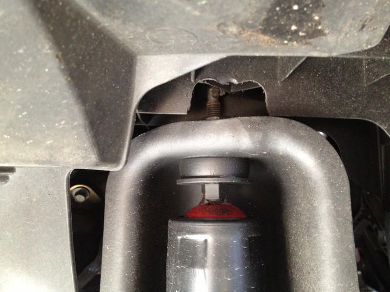

Tripletsi's Avatar
Posts: 1,208
From: Pittsburgh, PA
Ten Characters

Got it replaced, and I did cut the plastic. Floor jack made it easier to hold the shock in place as I put the bushing, the washer, and the nut on.
