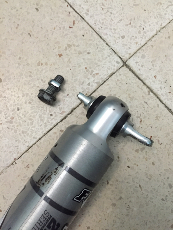

Hello everyone,
I have a rubicon with mopar 2" liftkit with fox shocks that i installed recently.
I went to a mountainous trail for the first time with the jeep and one of the rear shock absorber upper pin broke and the other one was bend. I contacted fox and they replaced the pin.
Have any of you experienced this? Why would it happen?
It came to me that they might fitted longer coils or something.
So I went to the dealer to check if there is something wrong with the kit but they said that all components are fitted correctly and they compared the car to another jeep with the same kit and the height measurements are similar.
Can anyone please with a similar setup on a 2doors wrangler tell me what's the height of the car after the lift so i can see that i didn't get longer lift.
Your help is really appreciated because i am afraid now that i am gonna put in the same situation again.

I would check pump stops as well, were you driving fast and bottoming out the suspension? Post up some photos of the bump stops and shocks with the jeep at rest and if you can post up some lengths of the shock shaft showing at rest and the distance between the bump stop and bump pad.
