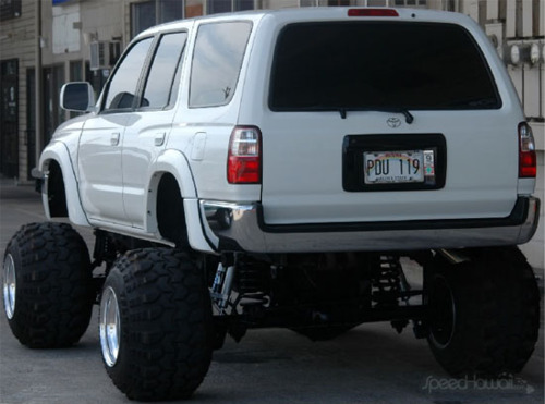

Are you from Hawaii?

Haha!!!! So that's what they look like huh?

Lol.......
