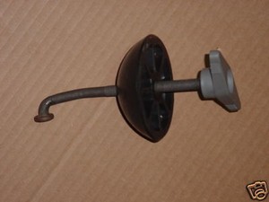

I've been thinking about removing my spare tire and some how placing it in the cargo area. I know this question has been presented before, but I haven't seen any real good solutions. I was woundering in anyone has taken a set (4) of D-rings shackel tabs and have them welded into the cargo area. This would give you at less mounting points and then you can use a set of tie-straps to anchor the tire down.
my main concern are my children and making sure their o.k and if for some reason we get rear-ended, I don't want that tire becoming a missile back there.
You can use some threaded rod and a coupler nut to extend the bolt so it goes high enough through the tire.
