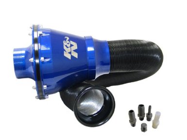

I came across this yesterday on the K&N site. It might just fill my requirements for a sealed (or seal-able) airfilter . I have it on order and should arrive tomorrow. I'll let you know how it works out.

Let me know if that works. I hate the RR bottom and the OEM top but don't you need a hookup for the breather tube that attaches to the OEM filter box top?? Where would that hose go without that?

Had same idea, received the filter but my Jk is still on the air tech ( bad evaporator). I,ll be trying it this night. I'll post pictures so we can exchange ideas. By the way I taught the filter body was aluminum but its plastic also the filter adapter requires an O ring or sealant in order to de water tight.
