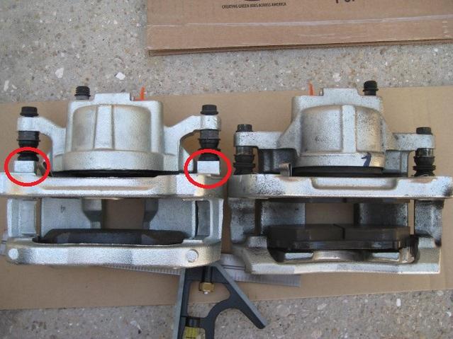

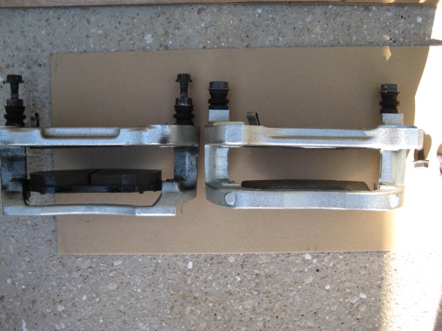

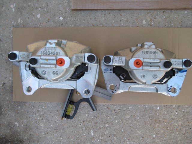

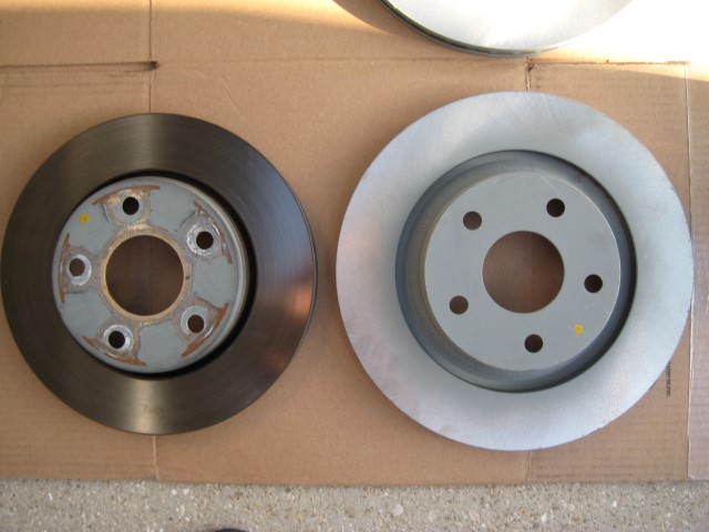

I did the BR6. I didn't get the booster or MC because the BR6 caliper pistons are identical to stock. And the rotors are actually 13.25". The aftermarket ones are 13". You don't really need the pin kits. The calipers come with pins. You just re-use your stock bolts. The BR6 calipers accept the stock pads but I did upgrade mine.

Thanks for posting the pics. After adding the weight to my Jeep, and now larger tires this thread got me thinking about upgrading my brakes, and what my options might be. The proprietary nature of the Dynatrac is a non-starter for me. The two Teraflex kits use Dodge 1500 bits but the OEM angle holds the most appeal to me.

Yes but the BR6 rotors are harder to get.
