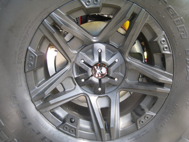

Thanks for posting the pics. After adding the weight to my Jeep, and now larger tires this thread got me thinking about upgrading my brakes, and what my options might be. The proprietary nature of the Dynatrac is a non-starter for me. The two Teraflex kits use Dodge 1500 bits but the OEM angle holds the most appeal to me.
You're welcome. If you decide to do the BR6s and have any questions just let me know. Here's the finished product.
Name:	BBK 024 (Small).JPG
<img src="https://www.jk-forum.com/forums/attachment.php?attachmentid=585858"/>
Nice I wanted those rims, but they were out of stock.
