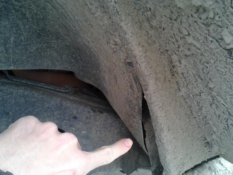

I had a similar problem with my Bushwacker flat flares... I cut the edge and bottom and made it fit.... See....
