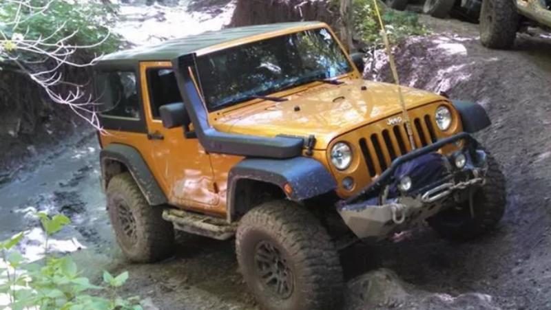

So you mentioned LCOG. And I know I will get a lot of hate for this suggestion. If you are only going with 35's I suggest buying the tires first, 1.25 bodylift, and if you want more clearance cut the fenders. My jeep has a body lift I bought off of ebay for $125. Most people don't realize I have one. I wanted LCOG because I like hill climbs and off camber trails. Yes adding a 3 to 6 inch body lift is dumb. But body lifts do have thier place. In your case with LCOG this would be one place to consider a BL.
Just curious.... You near Marble Falls? Hidden falls is fun. Only been there once tho!
