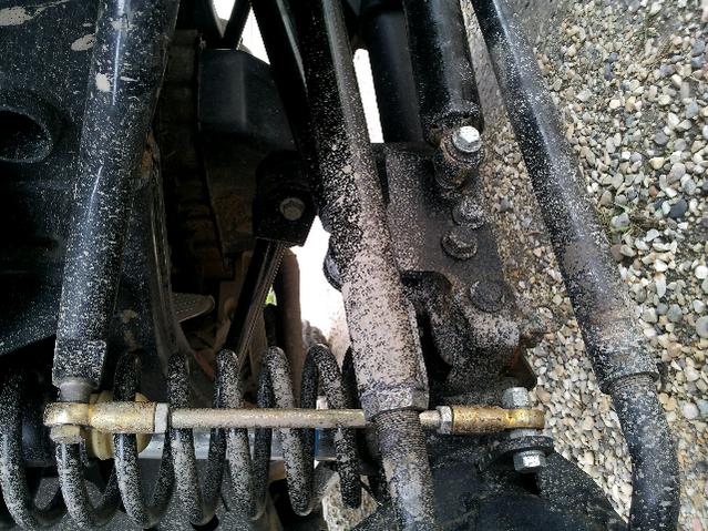

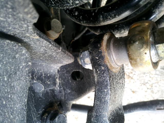

Im having the same problem right now... Installed the kit this week end and im sitting at the alignment shop.. Hopefully it will fix the problem... If not ill have to buy a new swaybar... Ill keep u posted
Old May 23, 2012 | 07:13 PM
superjk10's Avatar
Posts: 330
From: grande prairie
Originally Posted by cajun01
Set your links at 24" and don't worry about it
Correct me if im wrong but mine are 13" and they seem too long.. I think rk send me the wrong ones
Driver side

Driver side

Passenger side
