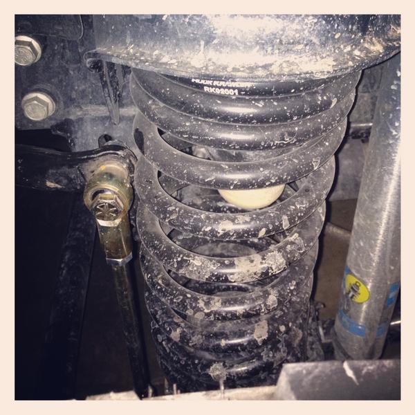

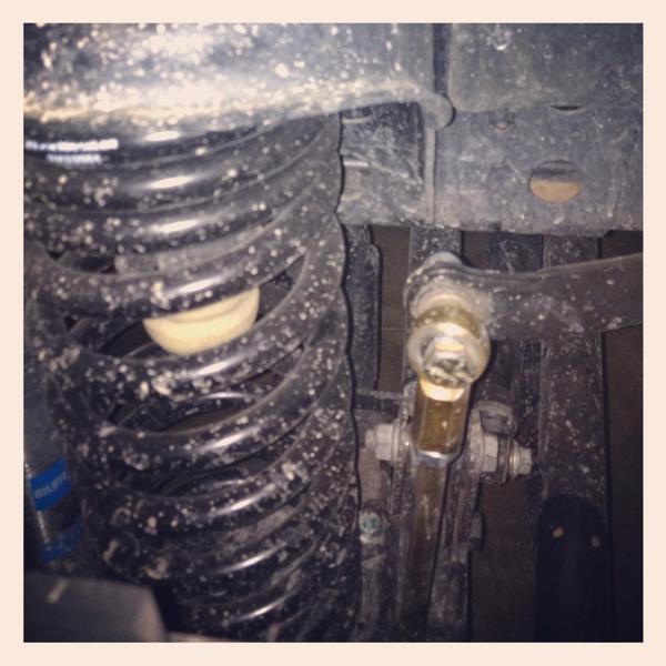

I just installed a rock krawler 3.5 x factor system and an having a problem with the front sway bar hits in the front coils. We measured all the front control arms to rk specifications. the left side hits the coils and the right side is less .5 inch away. Anyone have any info on this?

Haha you must have missed the thread on this last week.
You mean like this?
Apparently it's normal...
Got my install done at EVO...they said they contacted RK and they said it was fine....
Passenger.
Driver.
As I've said before, I've abused this suspension quite a bit in the past few months and it performs like a champ...Articulates like a mofo!

mine actually touches the coil if i stuff the right front tire the link gets caught on the coil.
Hmm, mine touches ever so slightly, never had that issue though...
