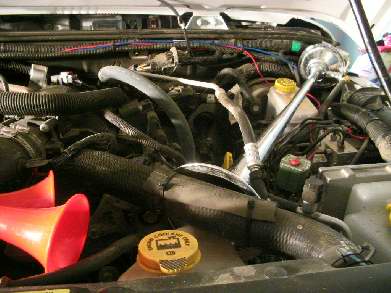

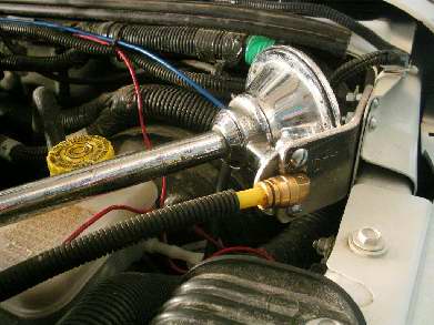

Old Apr 17, 2008 | 05:44 PM
mkjeep's Avatar
Posts: 15,665
From: Hammond Louisiana
This is where I mounted mine
Attachment 8081
Attachment 8082
hows yours sound? i want at least two.
Old Apr 17, 2008 | 08:19 PM
mkjeep's Avatar
Posts: 15,665
You don't need 2, trust me. I run my tank up to 140psi and can blow the fur off a squirrel in a tree. Dogs by my house run and hide when they see my JK pull up. Although a friend who helped with the set-up is wanting me to put a horn in the rear and both sides too.
Old Apr 17, 2008 | 08:25 PM
mkjeep's Avatar
Posts: 15,665
You could probably mount another one on the passenger side like the one one the drivers side, if you have the horns check the clearence you would have on the pass. side. I made the bracket out of thick spare aluminum, took all of about 10 minutes.Uh maybe 15, beer break you know
