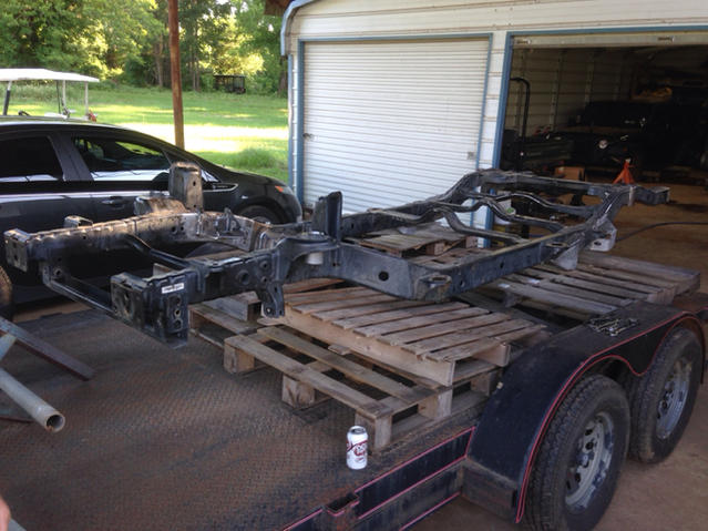

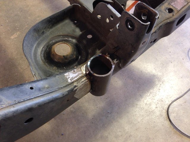

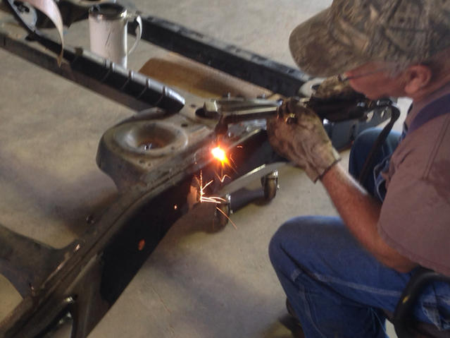

Here are some pics of the tera speed bump pre runner kit which mounts same as fox
ID:	559295   Click image for larger version
ID:	559296   Click image for larger version
ID:	559297   Click image for larger version
ID:	559298   Click image for larger version
