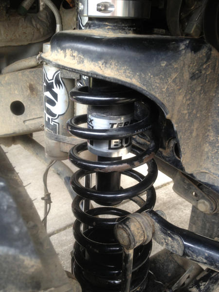

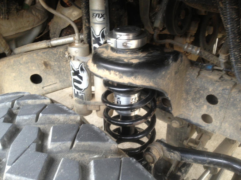

Yes they need to install in the coil and you will need to cut the cup at the bottom. I used rotozip with cutting wheel due to the tight space. I attached some pics for a reference.

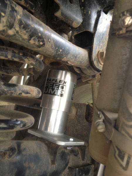

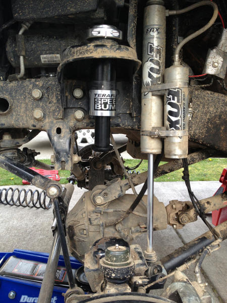

The rears mount on super easy it uses two bolts to secure them in place.
ID:	532586   Click image for larger version

Is this flexed? Or sitting level? Because if your sitting level... theres not much room for up travel is it?

You might want to do a bit more research,cause those pics are Teraflex speed bumps. Fox Bumps are mounted differently,specially the rears.

How do you actually assess required bumpstop height with these speedbumps on?

You guys are seeing them at their extended height. I'm not sure how they work. If there is a solid height or not.
Think of them as another shock extended/collapsed lengths.

I don't know about that. Look how much shock is left. And it looks like theres only an inch or two between the old bump stop and the Teraflex. Just don't look right to me.
