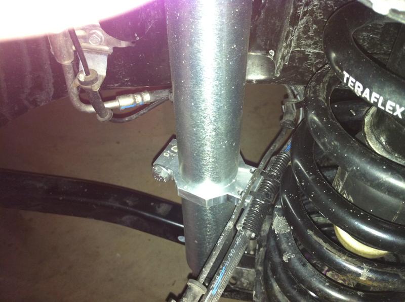

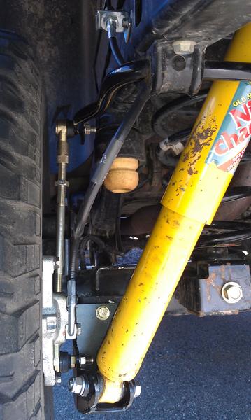

The stock front lines have plenty of length for most lifts. The problem is they are held to a bracket that is attached to the lower spring perch. I cut the bracket from the lines using a cut-off tool. When cutting this bracket free from the brake line you have to have a steady hand as the cut-off wheel will be very close to cutting the brake line itself if your not careful. Once I had the brackets cut off I made a couple of aluminum brackets that mount to the shock to hold the brake lines up a bit higher which give plenty of slack for a 3-4" lift. Here's a couple crappy cell phone pics.

yeah I thought it was funny that the "extended" front brake lines are the same length as factory on the 11's, you just mount them with the elbow facing the other way and without that bracket, for a ton more length! However I am a schmuck, so no cutting the bracket off for me
