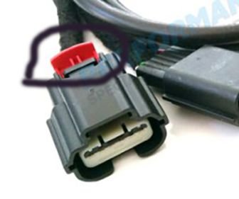

All, I am new to the forum and thought I would pose a question. I am trying to install a new Pedal Commander module but cannot get the original pedal plug off. All of the videos I've found don't match up to what I have in my 2016 JK Rubicon. I found the plug at the top of the gas pedal but due to large fingers and some other hardware in the way I don't have any leverage and cannot seem to get the dang thing unplugged. I've taken the panel off under the steering column and removed the 2 10mm bolts and the plate that they secure. There is a 5x5 inch module of some sort in the way of directly seeing the pedal plug. I don''t know what that module is for and dont know if it can be removed to get better access to the throttle plug on top of the pedal. Is there a trick to unplugging it the pedel plug like a clip of something that needs depressed or slid up or down?

I'm pretty sure, there is a red locking clip that has to be unlocked/slid back before you depress the lock on the plug to remove it from the throttle controller.

There are 3 studs/nuts to remove the pedal so I would recommend you just take the pedal off do the wiring and reinstall.
