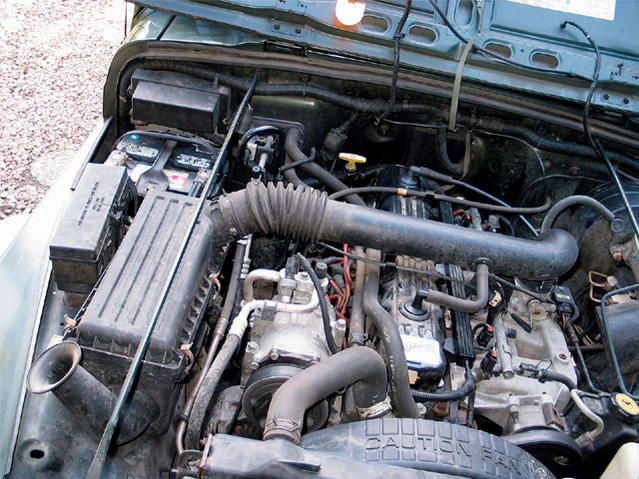

Here are the two pictures the TJ and the JK.. its hard to see on the JK but the large opening sits right where the hood meets the body and its fairly close and WIDE open.
ID:	34467   Click image for larger version

thanks for the pics, yea we have the same intake. if im seeing it corectly, why yall are saying the jk box sucks is with the opening right there at the hood, i could see how water could get in between the hood and body. besides that i dont see anythiong else wrong with it.
