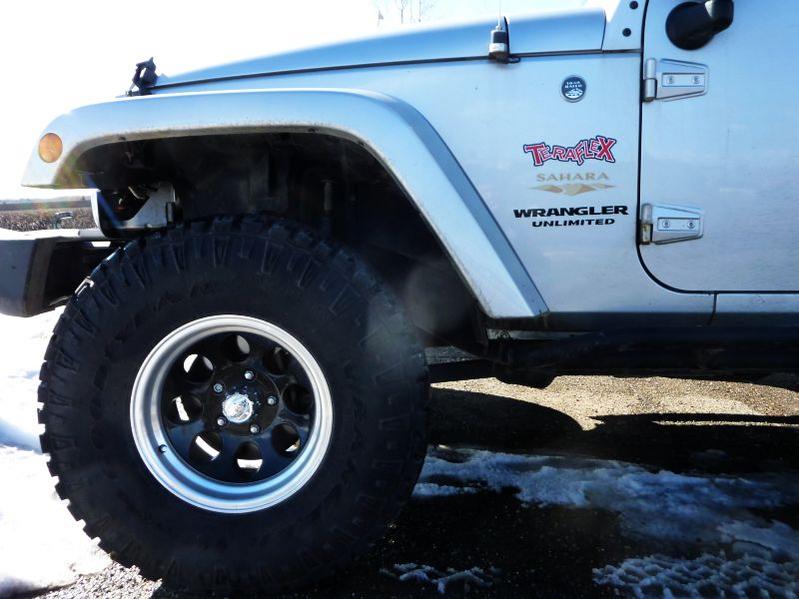

I am running 15x8 Ion alloys - the backspacing is 3.5" on the 15" diameter.

I am running Ion Alloy 171's but the 15" size. I think the backspacing is 3.5"

Thanks - I wasn't sure that the tire would stuff into the stock fenders with that much backspacing, but it works fine. 2.5" Teraflex coil lift.
