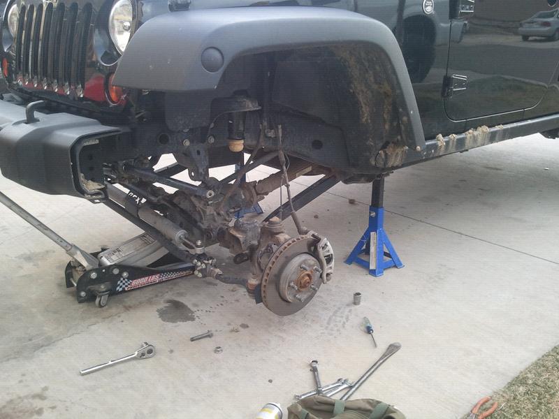

I just jacked up my jeep enough to remove the tire, removed the tire, set the jack stand and let her down.
<img src="https://www.jk-forum.com/forums/attachment.php?attachmentid=327159"/>
Very cool. I'm ready to get to it. Hey if any of y'all are near Tallahassee come hang out on Sat the 16. I'm buying.
Do you have both front tires off with jackstands on both sides of frame?
