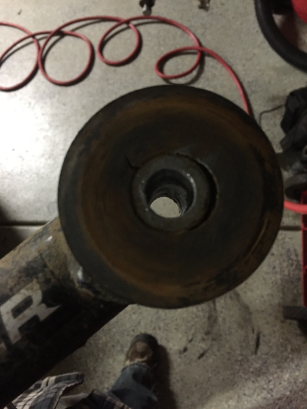

I agree with control arms... So what is the best way to inspect Krawler joints? When I take them off should I be able to rotate them at all? Here is the bushing end of one of the fronts...
That gap u see is very shallow. NOT all the way through.

Its cracked and its obviously worn. I would replace that bushing even if it wasn't the problem. It cant hurt, that's for sure.
And bushing like that should not be able to rotate.

The bushing doesn't rotate.
