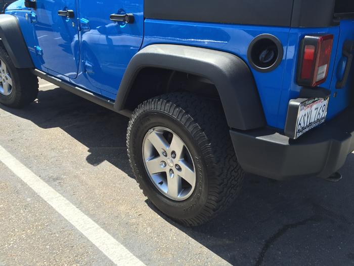

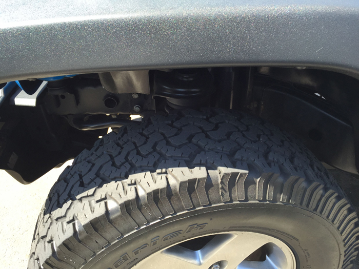

I am thinking about pulling the trigger on this the price is good mil;es are high and not sure if it is lifted the shocks look stock but he space above the tire to the wheel well is large these are 285 70 17 ties so the same as stock.. What can you guys tell?

It's got a budget boost

From the pictures it looks like there could be a spacer puck.

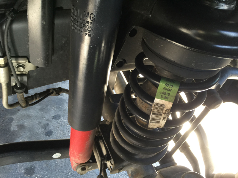

Name:	blue  jeep IMG_5116.jpg
Yellow Arrow - the spacer they are referring to.
Red arrow - that upper bumpstop extension says TeraFlex, correct? Should narrow down whose BB lift is on it...

Clearly has a spacer lift, looks like a 2.5 ", but it does look pretty clean down there from the one pic.

I also see a teraflex rubber bump stop. Looks like a teraflex budget boost. I Google the spring #, it is a stock mopar spring
