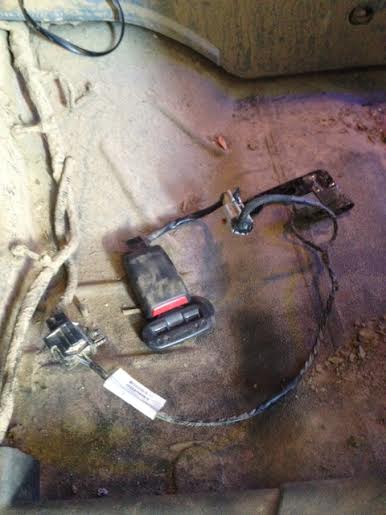

As mentioned, the yellow harness is for the side air bags you no loner have. The black wiring harness is for your seat belts.
After doing my cage I installed aftermarket seats and harnesses. I kept the drivers side sensor and seatbelt buckle and zipped tied them under my seat to fool the computer into thinking I have my seatbelt on. You may need to do the same thing or pick up a new sensor and harness.
Here's a pic of what I did to bypass the system.
