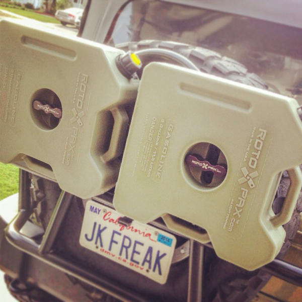

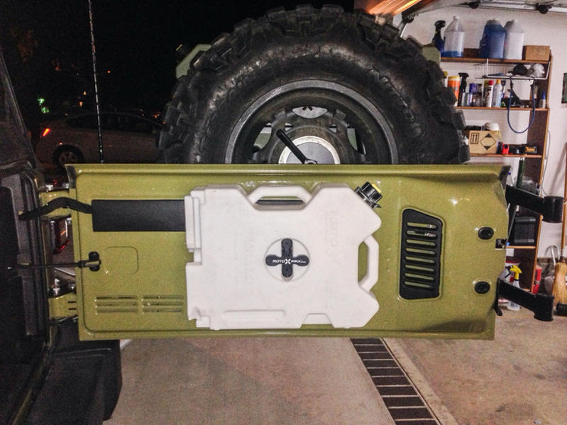

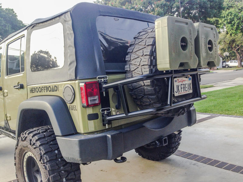

Just vent them once a day on the trail by opening the spout to release air pressure. Changes in temp and elevation tend to expand/contract the canisters.
I went with rotopax. You could drive over these things and they'd still work fine.

Thanks for the reply. Killer setup, really like the idea of the water Rotopax on the inside tailgate. Think I might have to borrow that idea from you
